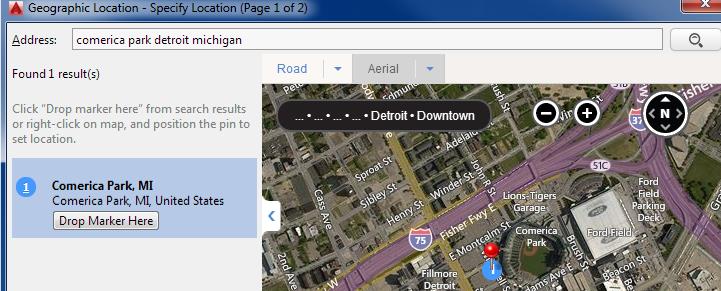

Since I am a big Detroit Tigers Fan we are going to search for Comerica Park, Detroit Michigan (Home of the Tigers) as shown in Figure 2. If you do not see this map image then you are not connected to Autodesk 360. In the address area type the location you would like to find.
Figure 2: Enter address of site location.
AutoCAD will now come back with the results and our location has been found. Drop the marker will place the location in the blue 1 as shown in Figure 3.
Figure 3: Drop the Marker

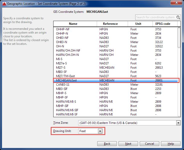

We will now have step 2 which is extremely important as we need to set the coordinate system for our map and or project. For this location we will use the Michigan East Coordinate System. If you do not know the coordinate system you can use the standard UTM coordinate system which can be found in the list below in Figure 4.
Figure 4: Coordinate System

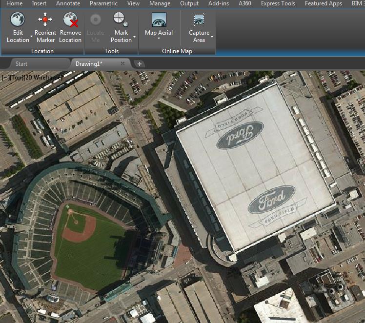

Hit next and you will be prompted for a location, hit return twice once for the location and next for the rotation angle. These will both be determined by your coordinate system. My map of Comerica Park (Tiger Stadium) is displayed as a georeferenced image within your drawing.
On the Geolocation tab of the Ribbon you now have several options for your map. You can edit the location which in some cases may be necessary if you have an incorrect coordinate system. Reorient the maker and Remove the Location are options as well. Sometimes I will remove the location after I complete a project and I no longer need the map for reference. If you are signed in to Autodesk 360, you can change the resolution of map images, modify their extent, adjust their opacity, or update them to the latest version available on the online maps service.
